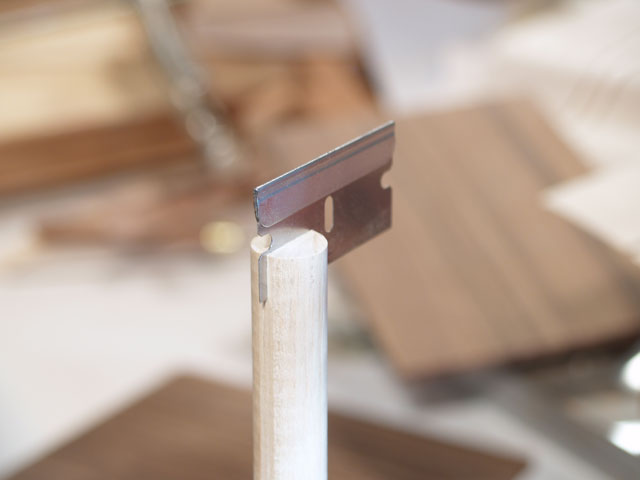

PostPosted: Wed May 30, 2007 2:35 am
Posts: 580
Last Name: Watkins
City: Lake Zurich
State: IL
John Watkins
CNC Guitar Parts
PostPosted: Wed May 30, 2007 3:11 am
Nice jig John,
I hoping to do a bursted guitar soon and that little blade and dowel will certainly do the trick.
